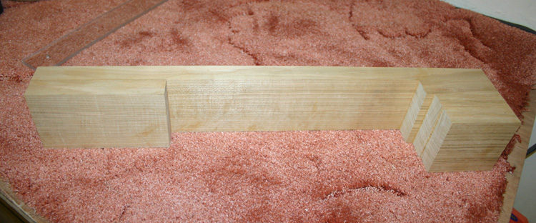

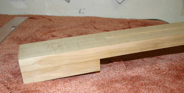

[QUOTE=RussellR] Dave
I think you arew right you will often see the joins in the stack, but I agree with you well executed they add interest.
I stack the Peg head and cut it at an angle rather than using a scarfe join.
Russell [/QUOTE]
Russell that is pretty cool. Art Overholtzer did his necks that way on a lot of occasions, and Art was THE man.

[QUOTE=John Kinnaird] [QUOTE=RussellR]
occasions, and Art was THE man.[/QUOTE]
Could one of you gents illustrate this method?
Even a shot of a peghead done in this manner would help a lot.
Thanks!chmood38659.3073958333

I haven't tried this yet, but I have seen it in the Kinkade
book.
Russell, what kind of wood is that?

Ron That English Cherry, ColinS tells me the Cherry in the USa is a different species.
